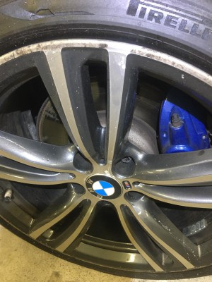

RAZ ROBILEM TAKIE FELGI I TAK ROBILEM WYROWALEM RANTY POOPCIERANE ZROBILEM REDUKCJE DO 240 POMALOWALEM CALE FELGI BASA POTEM MASZYNKA P500 GRADACJA USUNOLEM FARBE Z RANTOW GDZIE MA BYC SAME ALUMINIUM POZNIEJ PO MASZYNIE POPRAWILEM WLOKNINA SZARA PODLOZNO RYSY ABY KROTKICH RYS PO BACZKU NIE BYLO WIDAC I TAK LEPIEJ WYGLADA POTEM PRZYKLRYELM WSZYTKO LAKIEREM TERA PYTANIE CZY LAKIER NA SAME ALUMINIUM NIE ODPADNIUE ???
KTOS MI MOWIL ZE TE RANTY TO SIE POLERUJE JAK COS PISZCIE JAK
TERAZ MAM NASTPNE FELGI DIAMOND CUT JAK NA ZDIEJCIU USZODZONE TYLKO NA RANTACH
ROBIC MOJA METODA CZY JAK
